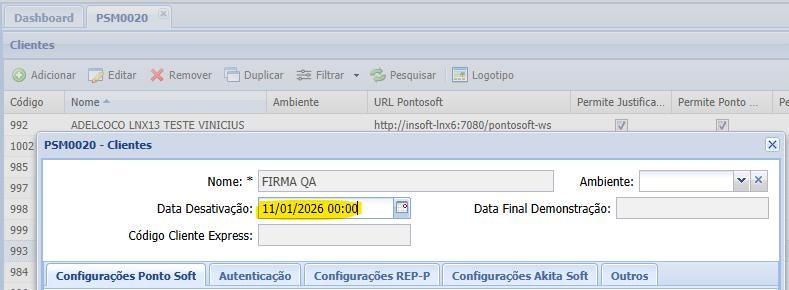

<p dir="auto"><strong>Data Desativação</strong> informada na <strong>PSM0020</strong>:<br />
<img src="/assets/uploads/files/1768243796284-beb7690b-e524-4ad0-8585-1bd3d5bd10e9-image.png" alt="beb7690b-e524-4ad0-8585-1bd3d5bd10e9-image.png" class="img-responsive img-markdown" /></p>

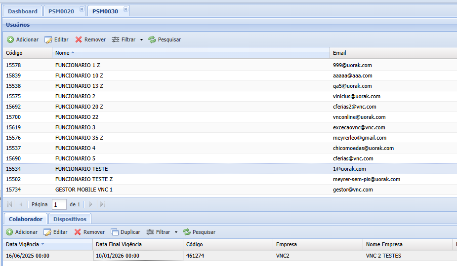

<p dir="auto"><strong>Data Final Vigência</strong> gerada automaticamente para <code>usuarios_funcionarios</code> na <strong>PSM0030</strong>:<br />
<img src="/assets/uploads/files/1768244016421-cac43a89-e5ef-4152-97f6-c9ad7a6ed17d-image.png" alt="cac43a89-e5ef-4152-97f6-c9ad7a6ed17d-image.png" class="img-responsive img-markdown" /></p>
