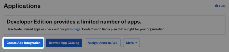

<p dir="auto">No portal do Okta, acesse <code>Applications</code> -&gt; <code>Applications</code> e clique em <code>Create App Integration</code>.</p>
<p dir="auto"><img src="/assets/uploads/files/1675339611174-1-resized.png" alt="1.png" class="img-responsive img-markdown" /></p>

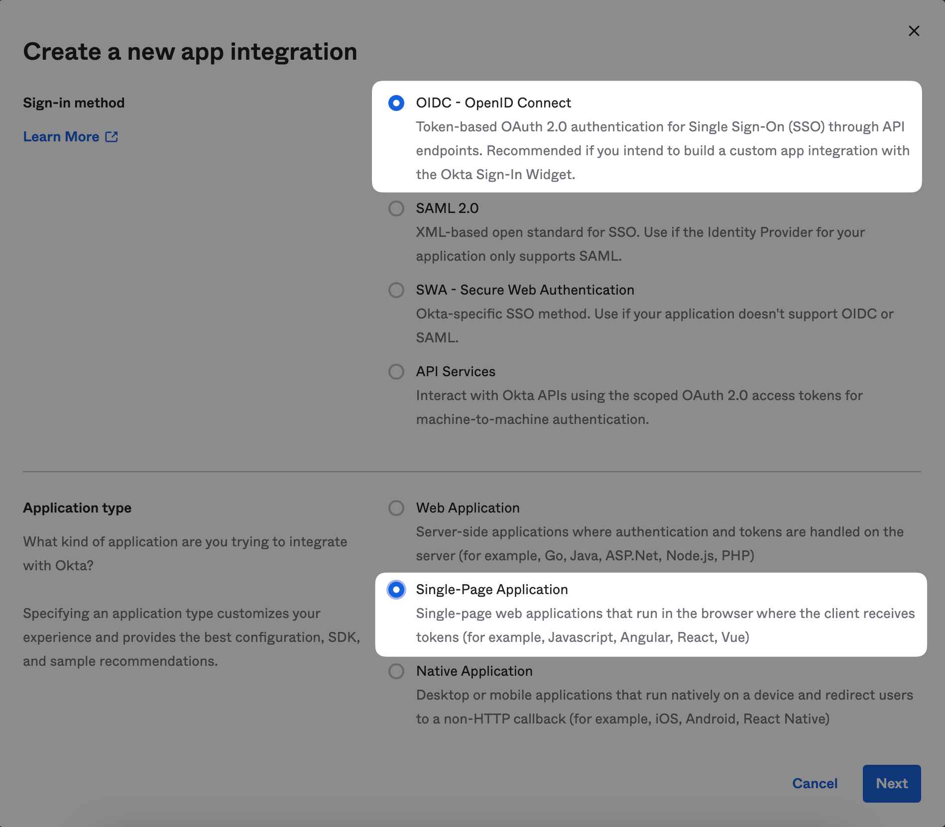

<p dir="auto">Selecione as opções <code>OIDC - OpenID Connect</code> e <code>Single-Page Application</code>.</p>
<p dir="auto"><img src="/assets/uploads/files/1675339624676-2.png" alt="2.png" class="img-responsive img-markdown" /></p>

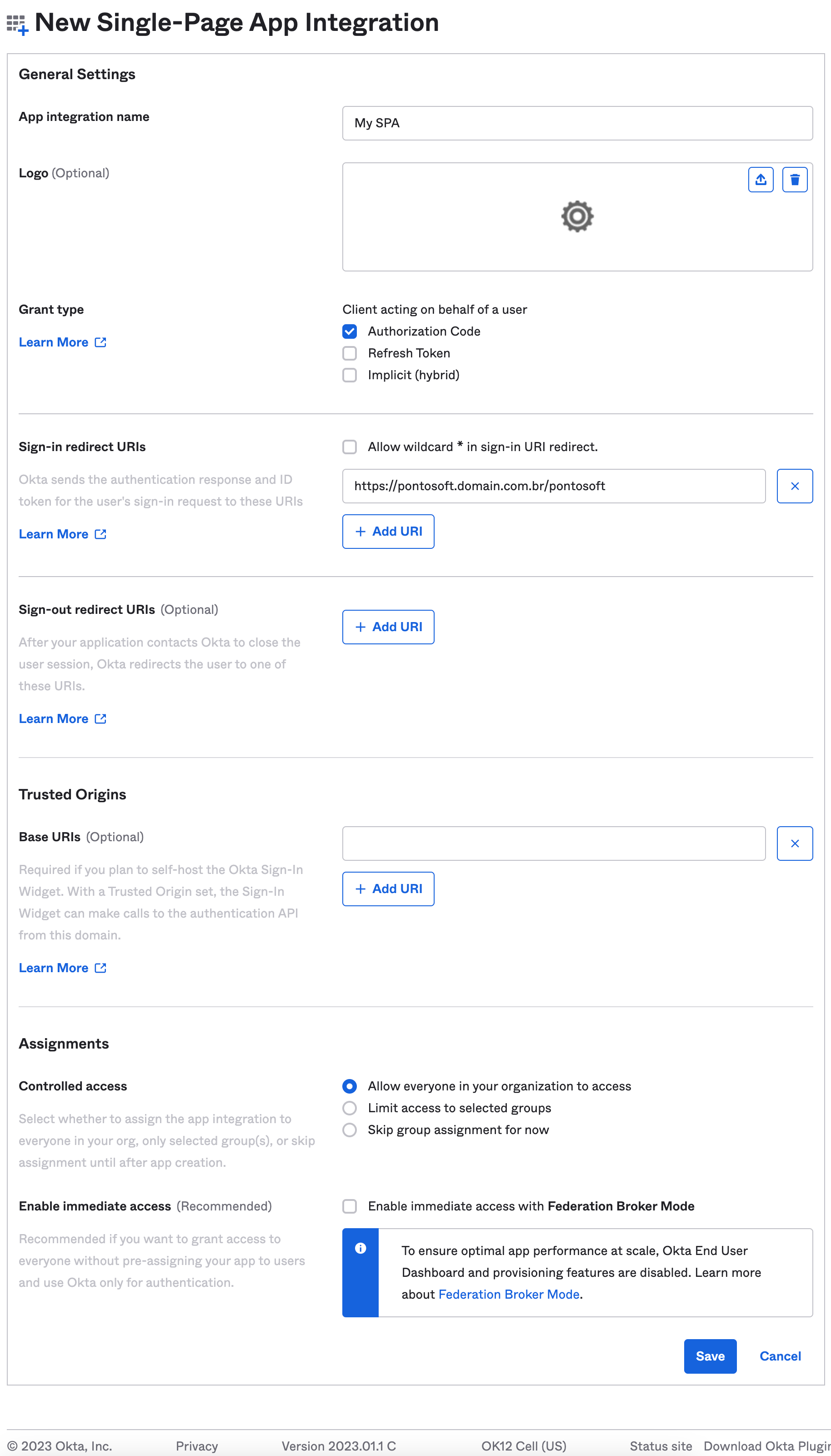

<p dir="auto">Em <code>Sign-in redirect URIs</code> adicione a URL onde a aplicação web está rodando:</p>
<p dir="auto"><img src="/assets/uploads/files/1675339636716-3.png" alt="3.png" class="img-responsive img-markdown" /></p>

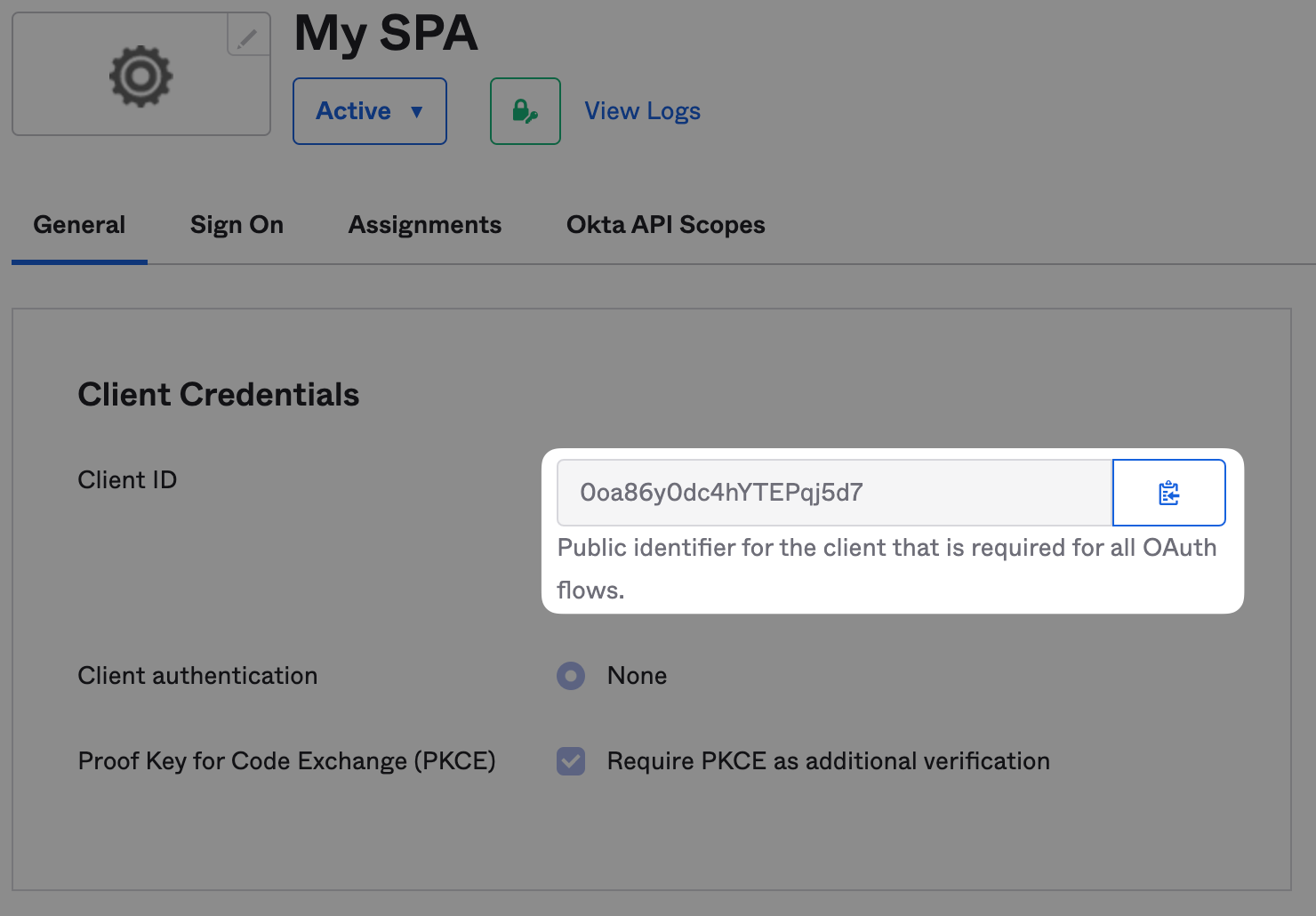

<p dir="auto">Copie o valor de Client ID:</p>
<p dir="auto"><img src="/assets/uploads/files/1675339648836-4.png" alt="4.png" class="img-responsive img-markdown" /></p>

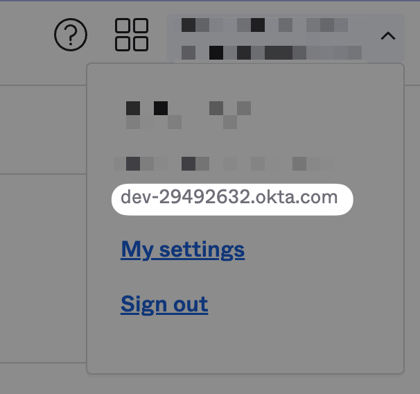

<p dir="auto">Copie o valor destacado:</p>
<p dir="auto"><img src="/assets/uploads/files/1675339656213-5.png" alt="5.png" class="img-responsive img-markdown" /></p>
